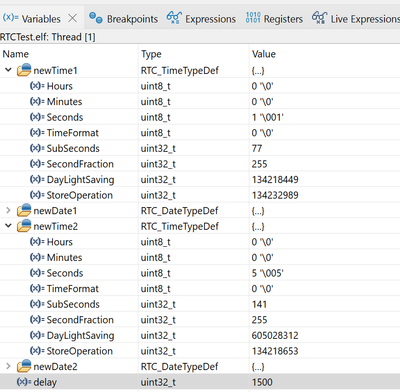

I would l have expected to see something like 4 in the newTime1.Seconds field. The blinking LED for loop runs 6 times with a 1500 mSec delay so a total of 9 seconds which I've verified with a stop watch. So I would have expected to see something like 13 or 14 second in the New Time2.Seconds field. But here's what shows up in the Variables window.
As a test, I modified the hrtc.Init.SynchPrediv from the default 255 to 127 and see newTime1.Seconds = 4 and newTime2.Seconds=19. But 255 is supposed to be the correct value for a 32.767 kHz LSE crystal according to the Reference Manual.

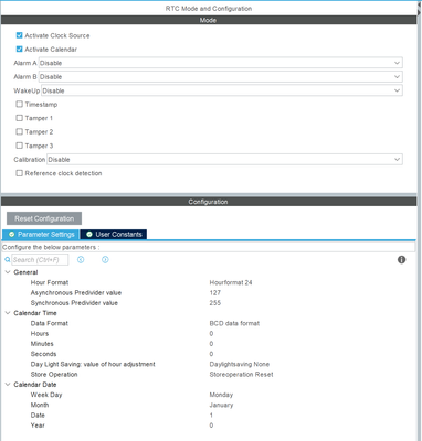

I started by creating a CubeMX project with nothing but the RTC enabled like this:

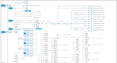

The clock configuration is this:

I think I figured this out. The RTC works fine when running off the LSI using the predividers recommended in AN4759. And it works fine when running off the LSE if I set the RTC synchronous predivider to 80 instead of the 255 recommended in the AN. The RTC timing was so far off, it didn't occur to me that my LSE could be that far off. I'll figure out a way to check the LSE rate with a scope when I get a chance and hopefully be able to get it dialed in by adjusting the load capacitors. Using the RTC alarms is one way to get the RTC rate but it would be better if I can figure out a way to check closer to the LSE.
