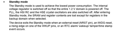

>The micro is in its deepest sleep state and the port pins flap
Depends on the sleep mode , if its Standby ...then, from ds:
and from rm:
So some pins still working (to wake up cpu) , but all other ... hi Z , off.
So better put a pulldown/-up on every output pin, that would float otherwise.
I do this always on "important" output signals, just because on every start/powerup the cpu is in reset and all (almost all) pins floating anyway.
(Input pins should anyway have some fixed state, from the circuit the signal is coming from.)
