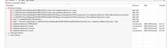

2024-08-06 4:55 AM - edited 2024-08-06 4:56 AM
Ive already made sure to include the paths in the includes section under the paths and symbols section.
this is the error I'm getting:
I was also trying to change the includs order of all the relevant files so that the USE_JPEG_ENCODER was defined before the jpeg_utils.h itself so that the jpeg_utils.c will have everything it needs while compilng
the complier finds the files but the JPEG_InitColorTables() function itself is still "locked"

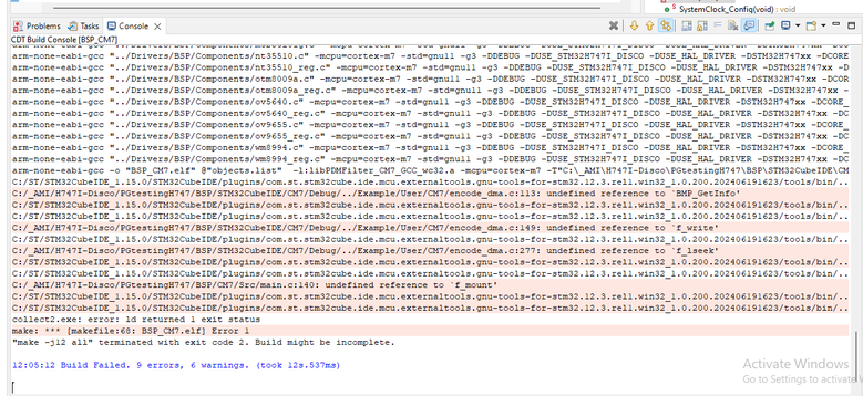

2024-08-06 5:37 AM
Show the full contents of the Console tab after you try to clean and rebuild.
2024-08-06 5:47 AM
Apparently the "clean and rebuild" did the trick, I'll continue to try and "play" with everything a bit more and continue to update here if I have more issues

2024-08-06 7:08 AM
@ElectroManiac wrote:this is the error I'm getting:
I think the 'Undefined Reference' is a Linker error - not a compiler error.
So this wasn't a problem with include paths/files.
As @TDK suggested, the Console output is a lot more informative that this "Problems" list

2024-08-06 9:34 AM
If you post the full output log as I requested above, I will look at it.
I can't help you if you don't participate. It is tiresome to reply to "X didn't work" posts without supporting information.
2024-08-07 2:07 AM
here's the current Console Status:
Here is the Problems tab for the full context:
