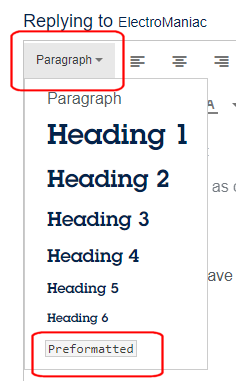

@ElectroManiac wrote:I was trying to add it as code here
That's the way I would have recommended until I recently discovered the 'Preformatted' paragraph option:
