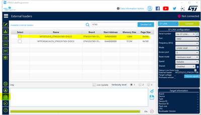

Hello @MReus.2 ,
Could you please try to use "MT25TL01G_STM32H745I-DISCO.stldr" under STM32CubeProgrammer path "...\STM32CubeProgrammer\bin\ExternalLoader".
I think it will work because the MT25TL01G_STM32H745I-DISCO" [support memory Size = 128M] for MT25QL512A [memory Size = 64MB]. So, the size of your memory is less than the external loader supported by STM32CubeProgrammer.
Also, to create your own external loader, I advice you to start with MT25TL01G_STM32H747I-DISCO external loader and get inspired by this FAQ "How to implement and use your own external flash loader: An example using STM32U5A9J-DK" by following the steps to create your own external loader.

Hello @MReus.2 ,

2024-09-19 6:23 AM
After upgrading to ST-Link V3 programmer it started working with the above mentioned loader.
Thank you!!
