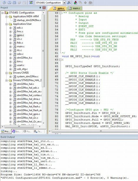

Using the brand new CubeMx version (4.2, released two days ago), I took the .ioc file, generated code for Keil 4.73: no issue in Keil, link with no errors, and the gpio.c file clearly present in the project.

I too am seeing issues with the generation of gpio.c using v4.2. I also have setup for seperate .c and .h. When I generated the files initially the gpio.c file was generated but afterwards when I make changes to the project in CubeMX and regenerate the files the gpio.c file is removed from the project....this is a real nuisance that I haven't been able to resolve.
The workaround mentioned above may work but is a real inconvenience.2014-05-11 12:45 PM
