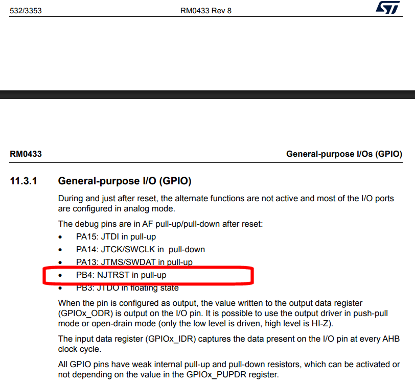

When Pb4 is reset, it is at a high level. Can't this be configured in the hardware? It's too disgusting. The PCB has been designed and encountered this pit.
2025-06-19 4:00 AM
PB4 is NRST - it's active low, so you'd expect its default state to be high.
This power-up state is clearly documented:
2025-06-19 5:26 AM
In addition to @Andrew Neil 's comments: no, it cannot be configured in hardware. An external pulldown could help here.

I know what you're saying, but it's frustrating to see that such high-end chips don't have internal settings. It's common for us to use MCU to control IO high and low levels, and this kind of setting makes users make mistakes. I think it's not just me, many users have used it before.

@奥特曼9527 wrote:it's frustrating to see that such high-end chips don't have internal settings.
Do you know of any chips which do have such settings?
It's a standard part of the design process to understand what the power-up state of the IOs will be, and design the rest of the circuit accordingly.
You should be able to find the (approximate) value of the internal pullup in the datasheet.
