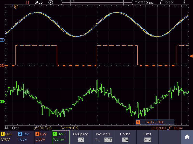

I use ADC1 and ADC2 to sample two 150Hz 2Vpp sine wave signals. There is 100us phase difference between signals. (Blue is delayed) I start the ADCs simultaneously from TIMER1. When HAL_ADC_ConvCpltCallback() is called I read the ADC1 (yellow) and ADC2 (bule) conversion results. I generate the ADC1 – ADC2 signal with DAC1. Because the ADCs are in 16-bit mode but the DAC1 can handle 12-bit numbers only I right shift the ADC result by 4 and subtract the 12-bit numbers.
uint32_t difference = (chn1Data >> 4) - (chn2Data >> 4);I write the value of difference variable into the DAC1. This is the green channel.

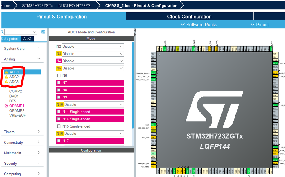

The ADC isn't enabled in the IOC you attached.
But see my edit above, it definitely seems like CubeMX can set a too-high ADC clock without any warning. I could be missing something.

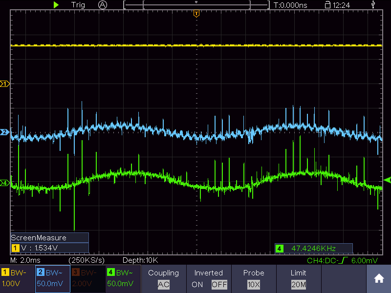

The battery test
I connected an 1.5V AAA battery to both ADC inputs: ADC1_INP15 (PA3) and ADC2_INP10 (PC0). I used my application which takes samples with 12800Hz and starts the ADCs simultaneously form TIMER_1. When EOC (End of conversion) interrupt happens I write the conversion results of ADC1 to DAC1.CHN1 (16-bit to 12-bit conversion is needed). When both ADC results are available then I subtract ADC1 conversion results from ADC2 conversion results and write the difference code to DAC2.CHN2. This way I can check the ADC1 conversion results and the difference between ADCs on an oscilloscope. Each conversion is saved in 3 buffers. The buffers can store the last 128 ADC1 and ADC2 conversion results and the difference between ADCs.
I would expect that the difference signal is around 0V (+/- 1-2bit). Don’t forget: both ADC inputs are connected tot same 1.5V battery. But what I get is 50mV sine around 50kHz! 50mV difference between ADCs connected to same 1.5V battery, even not DC signal? That is unexpected..

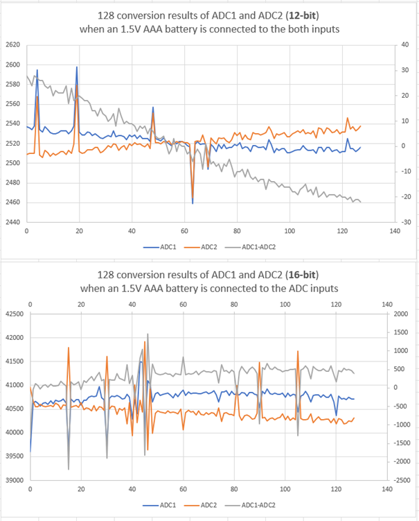

In order to make sure this is not a scope issue put a breakpoint and halted the program when the buffers were full. Then I copied out the last 128 samples from the ADC1, ADC2, and DIFFERENCE buffers from the CPU memory. I simply pasted the data into an Excel sheet and created a graph. I repeated this test with 12-bit and 16-bit ADC modes.
The scope results are right. This is AD converter issue. I still do hope that I did something wrong during the initialization and somebody can explain what. STM experts?

Concerning your 1st picture, if I understand you correctly: the green scope signal shows the DAC output, which is ADC1 - ADC2 + bit shift? Then the green signal is not too far from what I expect: noise + difference due to phase shift (mostly) and imperfect ADC accuracy.
