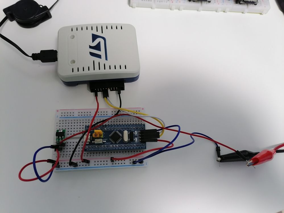

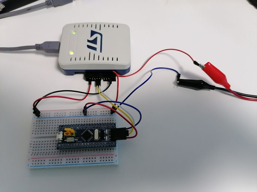

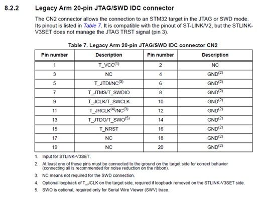

1. Here is the pins connection layout using CN2 JTAG:
+5V external ----> T_VCC pin 1
GND ---------------> GND pin 20
SWDIO ------------> T_SWDIO pin 7
SWCLK ------------> T_SWCLK pin 9
The actual connection is like below:

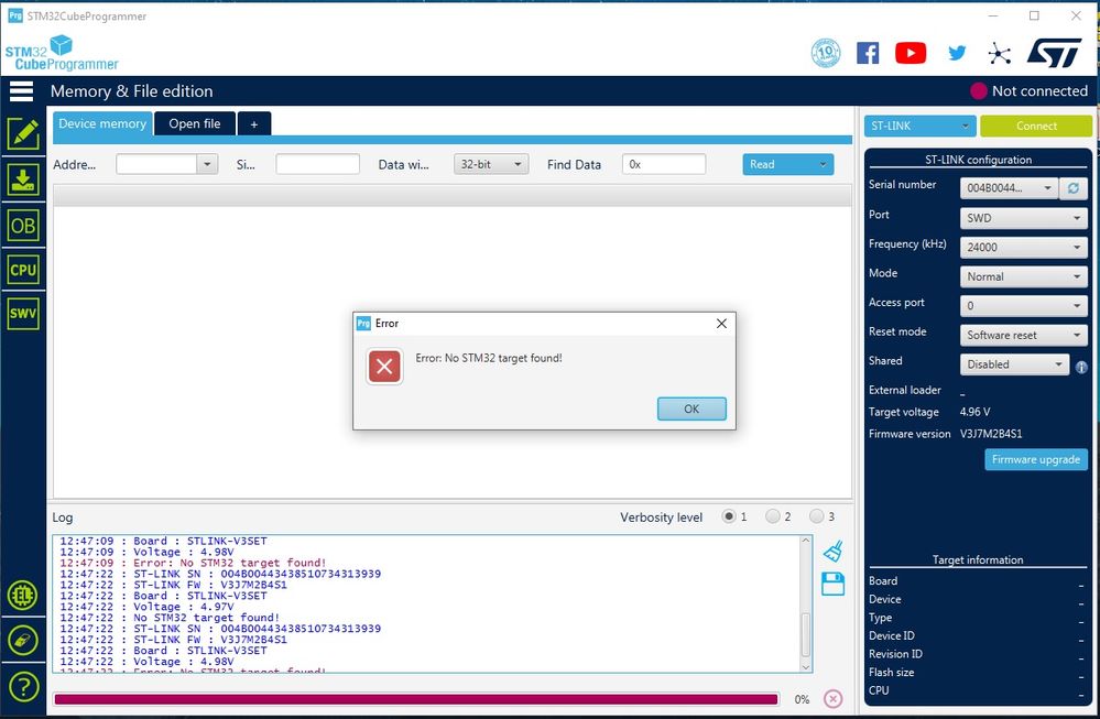

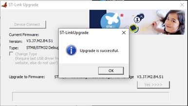

STM32CubeProgrammer already upgraded to latest ST-LINK V3SET firmware V3.J7.M2.B4.S1,
but I am unable establish connection to the STM32F103C8T6 board as shown picture below and the STM32CubeProgrammer CANNOT BE CLOSED:
I have reset by pressing the RESET button ( Software/Hardware reset options selected ) then followed by clicking the Connect button, the result still the same as shown above, any idea ?

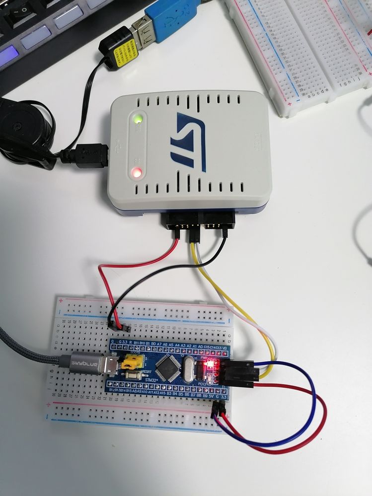

2. The ST-LINK V3SET COM LED from the datasheet is stated Red color on power on, but sometime I notice it auto turned to Green color, is this normal ?

VTarget of 5V is clearly inappropriate, thing should be running at 3 or 3.3V
2021-02-22 4:17 PM
https://stm32-base.org/boards/STM32F103C8T6-Blue-Pill.html
There should be a 5V supply pin you can use on the board. Connect that up, and then the Pin 1 of the SWD header should be at 3V3, and you can use that as VTarget (Pin 1 JTAG)

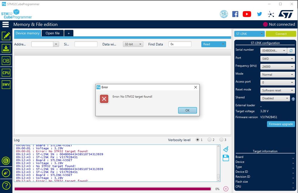

Yes, I did tested it using a MC33269 3.3V Voltage regulator as picture shown below, the SWD interface of STM32F103C8T6 is 5V tolerance input which I have tested it using +5V from ST-LINK V2 before:
Seems.... my setup above, is using the output +3.3V from Voltage regulator to drive both STM32F103C8T6 and ST-LINK V3SET JTAG but still failed.
Please advise.
2021-02-22 4:26 PM
However, the result still the same unable to establish connection between STM32CubeProgrammer and the STM32F103C8T6 clone board and the STM32CubeProgrammer CANNOT BE CLOSED.
Please advise.
