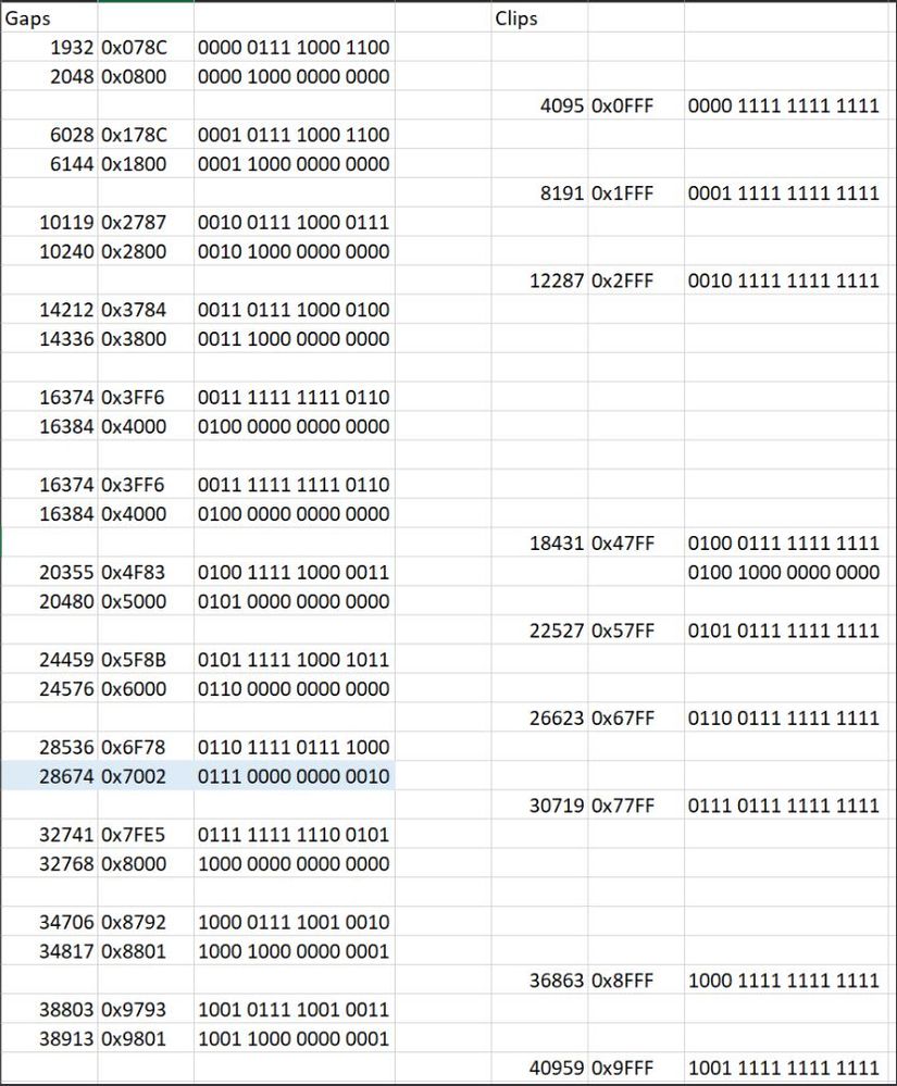

2022-12-01 7:22 AM
And the explanation of the process issue is that a slow clock speed could allow some of the capacitors of the SAR to discharge before the comparison and DAC operations are performed? I'm trying to get to an explanation of how the process fails. The gaps manifest in powers of 2 and happen when the least 4-8 significant bits are all ones and the next most significant bit jumps from a 0 to a 1.

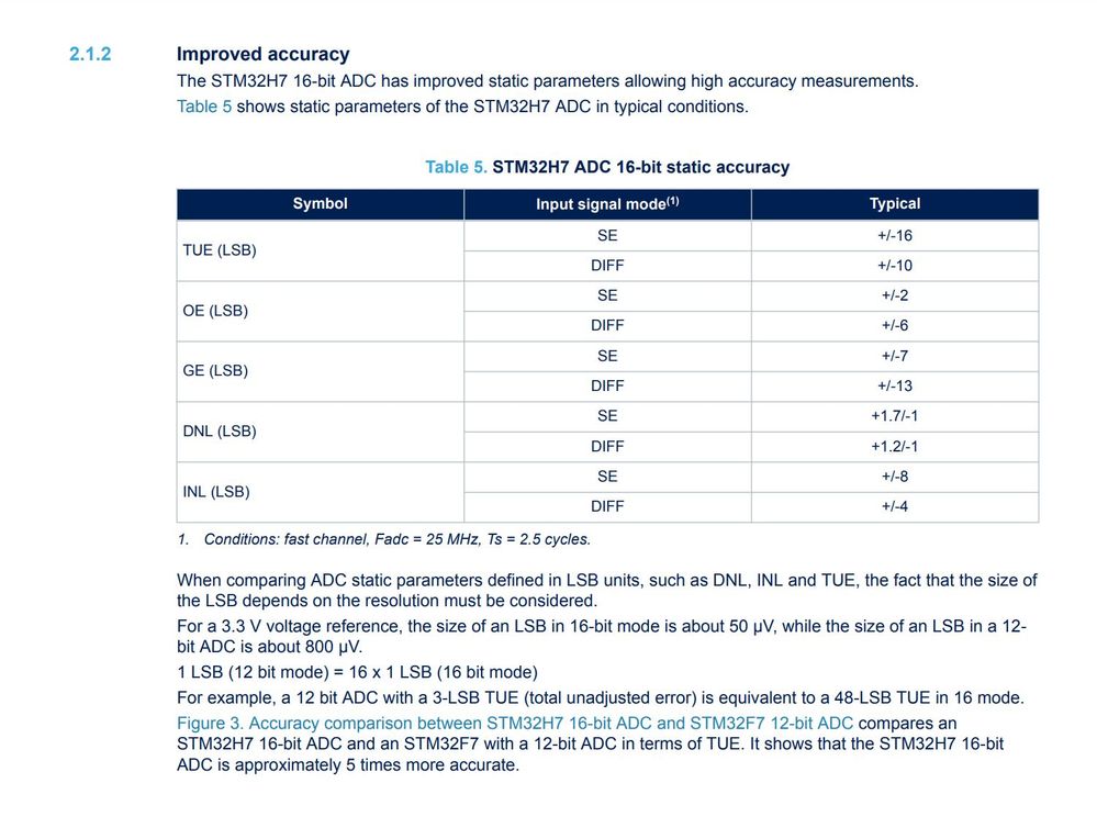

2022-12-02 9:15 AM
Here is a screenshot of the DNL for the 16 bit ADC. I am seeing +1.7/-1. I am assuming this means you can have a swing of +/- 2LSB worth of data. That doesn't seem to add up to the gapping we are seeing. Or am I misreading this? We don't need absolute accuracy, we just need to overserve all of the codes without gaps.
2022-12-02 9:20 AM
Here is a spread sheet of when/where the gaps and clips occur. The numbers under the gaps are the minimum and maximum values around a gap. As in, the low number is the bottom of the gap and the larger number is the top side of the gap. This data was generated using a function generator and applying a triangle wave (see image in original posting).

You are referring to AN5354, plz indicate next time what documents. Pay attention that "application note" is kind of different type compare to "Data sheet".
+3/-1 LSB I took out of DS12556 Rev 6 page 274.
Anyway, both values are "Typical".
When I read "Data guaranteed by characterization for BGA packages. The values for LQFP packages might differ." I fill like it's written by a lawyer or politician - not an engineer. Nothing to comment. Simply means you can observe any kind of misbehavior out of ADC, manufacturer has no idea and nothing guaranteed. With all due respect.
