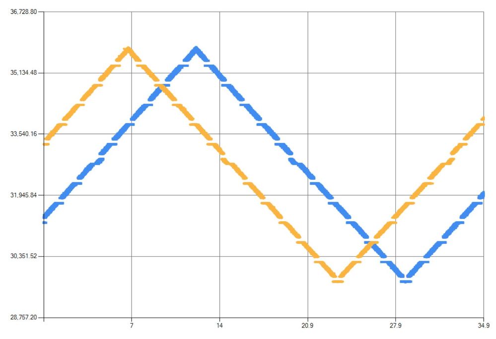

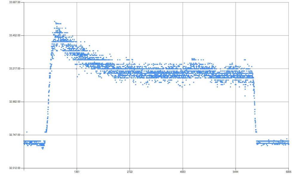

We are using ADC 1 and 3 to capture analog pressure sensor readings. We observed a gapping phenomenon in the output data where the ADC failed to output data in specific ranges consistently.
We discovered that using the ADC_CALIB_OFFSET was incorrect and switched to ADC_CALIB_OFFSET_LINEARITY. We also calibrate every power cycle and account for temperature drifts. Despite all of this, on approximately 25% of the units we still see this gapping with the same version of firmware.

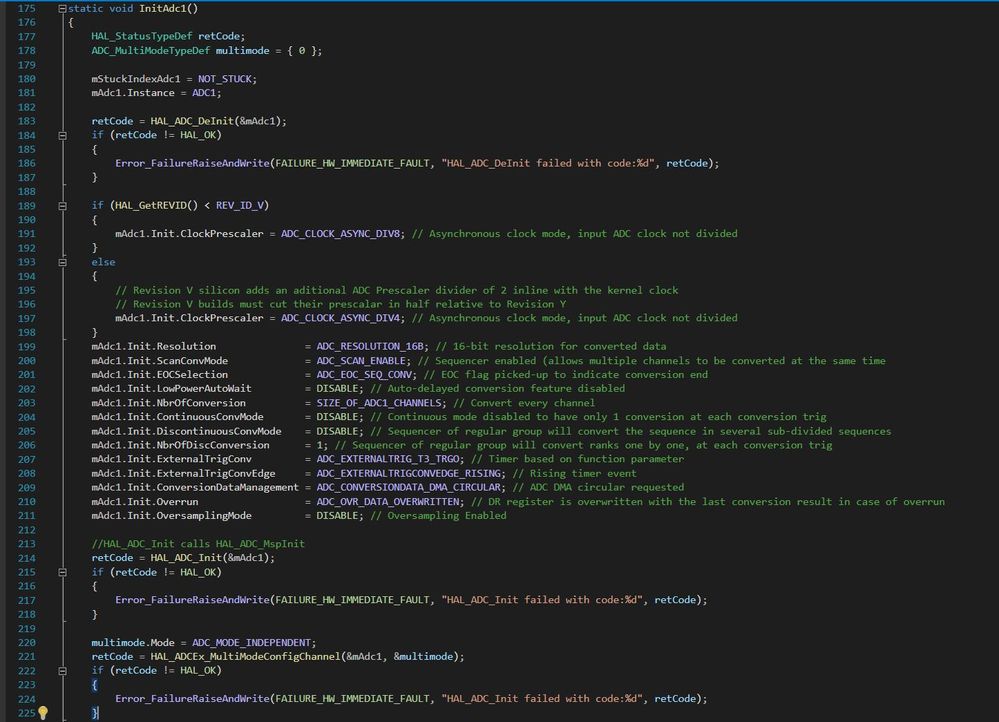

*Update - Adding in ADC Configurations via images
2022-11-30 11:32 AM
Update:

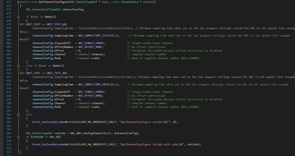

you driving the adc almost at its extreme frequ. , hi or low end.
what its doing, if you choose lets say 20MHz adc clock and 7.5 or more sampling time ?
2022-11-30 2:38 PM
You didn't tell what is sampling time. If it's long enough x 5 channels , there is a possibility adc has no cycles to complete some conversions
2022-11-30 3:01 PM
Running the ADC's at 20Mhz and 32.5 sampling cycles works well as well.
2022-11-30 3:01 PM
Sampling time is set to 32.5. I have tested with other sampling cycle counts as well. If I am asking for conversion faster than it can serve, I will see my sampling rate decrease as it takes longer to convert.
