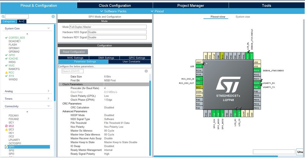

I'm not pretty sure what I should to do more for properly running SPI in H523. My setup looks like:

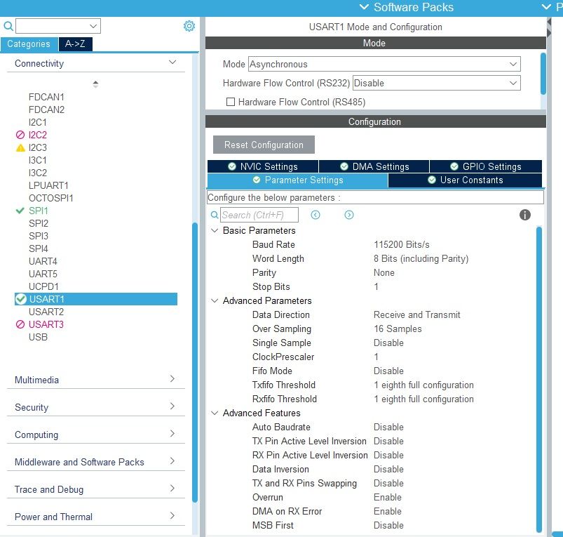

UART1 on PA9/PA10 working without any problem, but the HW SPI doesn't. IOC file in attachment. I'd look at this via oscilloscope. CLK look like work properly, also MOSI he's not dead. Should I do any additional configurations or so?
