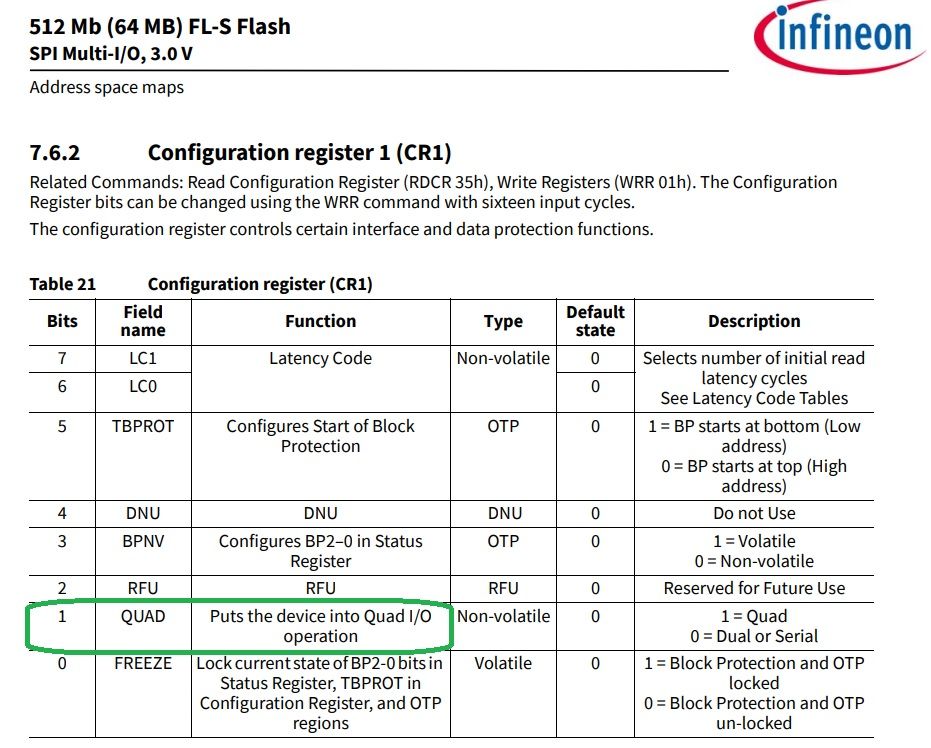

2024-03-06 8:55 AM - edited 2024-03-06 8:57 AM
You have to enable QUAD (pins) in Configuration Register 1, it's sticky, but you need to read it, make sure it's set and write it back.
Might want to double check the other status and configuration registers, if you use the wrong loader these can get set incorrectly, potentially write protecting blocks, or preventing erasure.
The 512Mb / 64MB device will need to get into 4-byte addressing mode, or you can use the 4-byte variants of the command to be explicit.
The part has a rich command set allowing for many possible permutations.
