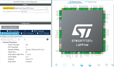

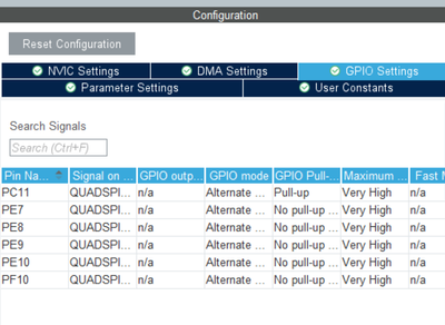

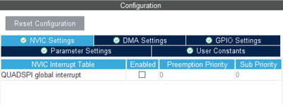

Hello I am in the task of adding a new flash as an external flash via QSPI interface with the MCU STM32F777ZITx.
The flash that I want to add is S25FL256L as an external flash. I am not finding any references which I can use with this flash. Also it is not getting clear to me whether I need to make an external loader for mapping the external flash in memory mapped mode or only configuration is needed ?

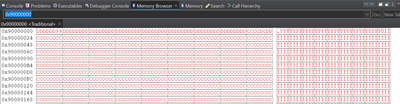

I am facing this problem where the call to the CSP_QSPI_EnableMemoryMappedMode does not fail but the external flash looks like this even after writing something

You should be able to implement read, write, and command functions to interact with the memory. Try reading the JEDEC ID and some pages first. Once you have that working you can provide this "Read Template" functionality to the Memory Mapping mode startup process, and then access to the 0x90000000 region will use that to allow the MCU to read the content.
Yours looks like the memory mapping still isn't working, and the access to 0x90000000 is faulting.
Start by reading the data/sheets and manuals for your S25FL256 memory, and get that working in your own BSP code.

Configuration here, but blank content will be 0xFF
Unconfigured, accesses will Hard Fault. Have a Hard Fault Handler that outputs actionable information so you can diagnose / debug the situation.
