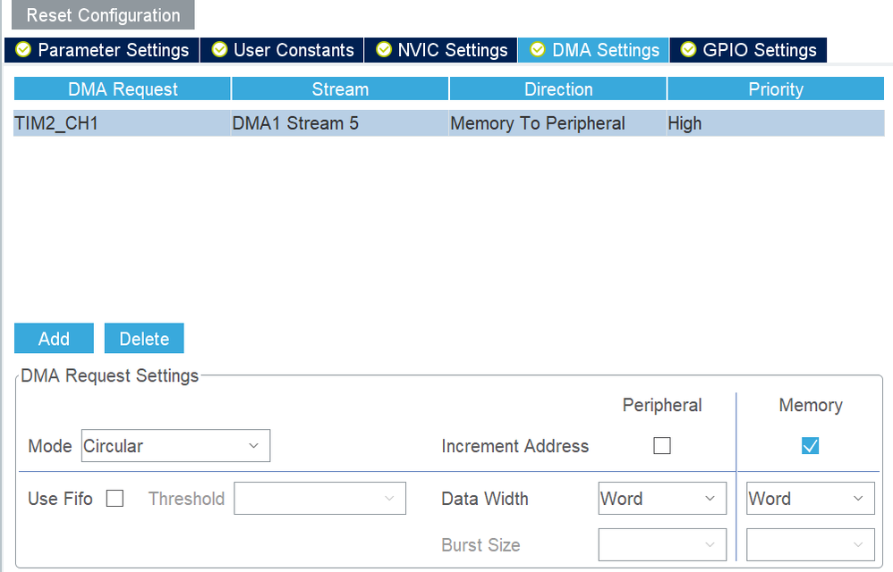

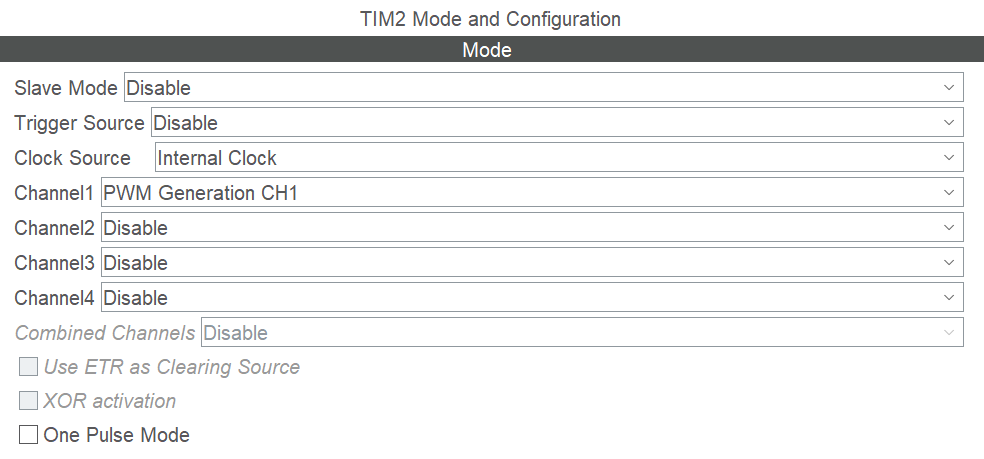

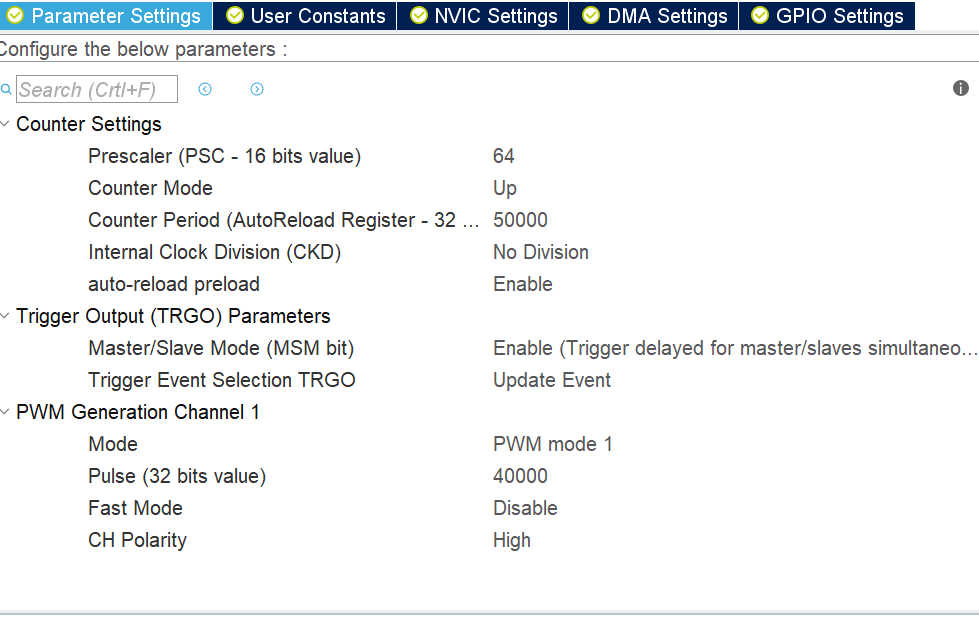

Hello again ,
i tried it now with arbitrary waveform. But it did not work. I think it's up to the configuration because I can not program registr. I would be glad if someone could help me. I created a array of 6 words for two waveform patterns to be send to TIM2 channel 1 (TIM2_ARR, TIM2_RCR, TIM2_CCR1) This is how the basics look
uint32_t aSRC_Buffer[6] = { 2000,1,800,3000,2,200}; /// ARR, RCR, CCR1 x 2. But i donot see any signal on the Oszi except one Signal because of this function HAL_TIM_PWM_Start(&htim2,TIM_CHANNEL_1);.
Summary of the configuration: i am using Nucleo STM32F767ZI board.
Timer clock = 64 MHz
clock source: internal
PWM generation CH1
Prescaler = 64
counter mode = Up
period = 50,000
- Pin PA8: TIM2_ch1_output
- Fashion: push pull
- Pull: pull-up
- Speed: high
/* USER CODE BEGIN 2 */
//HAL_TIM_PWM_Start(&htim2,TIM_CHANNEL_1);
HAL_TIM_DMABurst_WriteStart(&htim2,TIM_DMABASE_ARR, TIM_DMA_TRIGGER,
(uint32_t *)aSRC_Buffer, TIM_DMABURSTLENGTH_3TRANSFERS);
/* USER CODE END 2 */@Community member @S.Ma #[STM32 MCUs] #DMA
