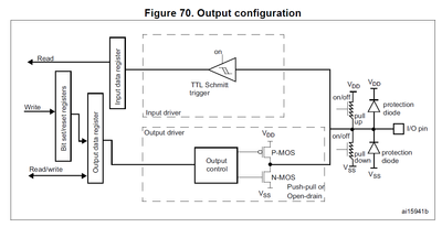

> I've tried to bypass the HAL and write directly on the registers MODER and ODR, and the IDR register value change as expected
Oh, if IDR/ODR are behaving as expected, the output pin on the STM32 is seeing the correct state. So no code bug, no need to look further into that.

BGA soldering is a frequent cause of issues. Board assemblers can x-ray it to verify the BGA is soldered correctly. Good ones will do this automatically, but of course they will cost more than the cheap ones.
No other insights here. Odd that ALL of the LED pins are not working though.
Can't see a scenario where IDR mirrors ODR correctly and yet the pin isn't actually being toggled. Input and output functionality is connected at the pin itself.
