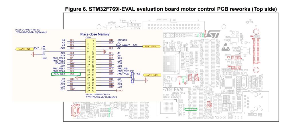

The PG10 in the CN11 silkscreen doesn't match the schematic, it is wired to PG6
This stub would likely cause the MicroSD card to fail. Probe PG10 at the second SD card

Thank you so much for this information. It seemed like a hardware issue but I didnt have anything to back it.
Is there a list of open/known issues anywhere? I didnt find one on a quick search. I am surprised something like this slipped through and they haven't rev'ed the board. Makes me wonder what else is wrong... Would explain why the toggle behavior gets weird when I set PG10.
2020-09-16 6:38 PM
As @Community member said above, the headers are incorrectly shorted together. I thought I did a continuity check before but I probably hit the wrong pins because they are so small and close together. I finally got some nice wires and can verify that PG6 and PG10 are shorted between CN5 and CN11. Probing the real PG10 is going to be another matter, though.
