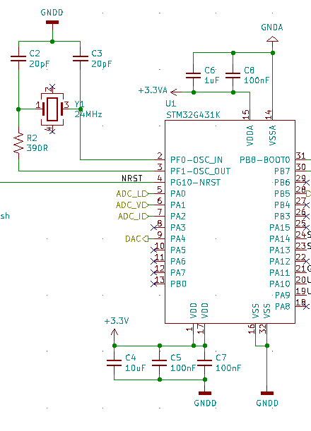

Here is the supply schematic, I separated the Digital and Analog supplies by a filter.

It turned out to be a poor soldering problem.
