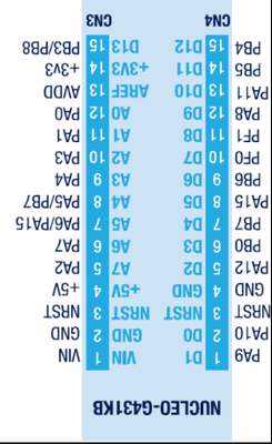

Actually I noticed something. I use nucleo card. And timer 3 is PA6 pins, timer8 is PA15. They r short circiut on nucleo board.
