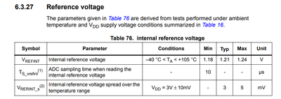

Hello @sal92,
According to your product datasheet, the internal reference voltage (VREFINT) for the STM32F733xx is typically 1.21 V, with a minimum of 1.18 V and a maximum of 1.24 V.
