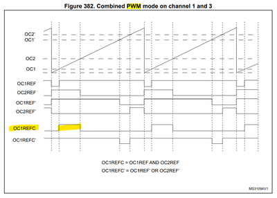

Very doable with a number of methods
Perhaps the easiest is to use the scheme that almost works except use PWM mode 2 and set it so output is low at CNT=0, high at CNT=1... X, and then low again until it reaches ARR.
If you need them to exactly match, you could use TIM8 in gated slave mode to get exactly 4 pulses at the start of each TIM1 period. Can describe this more if you need.

Ah the combined mode, I hadn't considered that but I'm sure that will work. The single count offset is no problem. Thanks a lot!

// 12: Combined PWM mode 1 - OC1REF has the same behavior as in PWM mode 1. OC1REFC is the logical OR between OC1REF and OC2REF.
// 13: Combined PWM mode 2 - OC1REF has the same behavior as in PWM mode 2. OC1REFC is the logical AND between OC1REF and OC2REF.

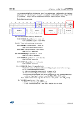

TIM8->CCMR1 |= (0x12UL << TIM_CCMR1_OC2M_Pos); // 1. 0x12/0x13 != 12/13
2. TIMx_CCMRx.OCxM bits don't form a continuous bitfield (for historical reasons)
