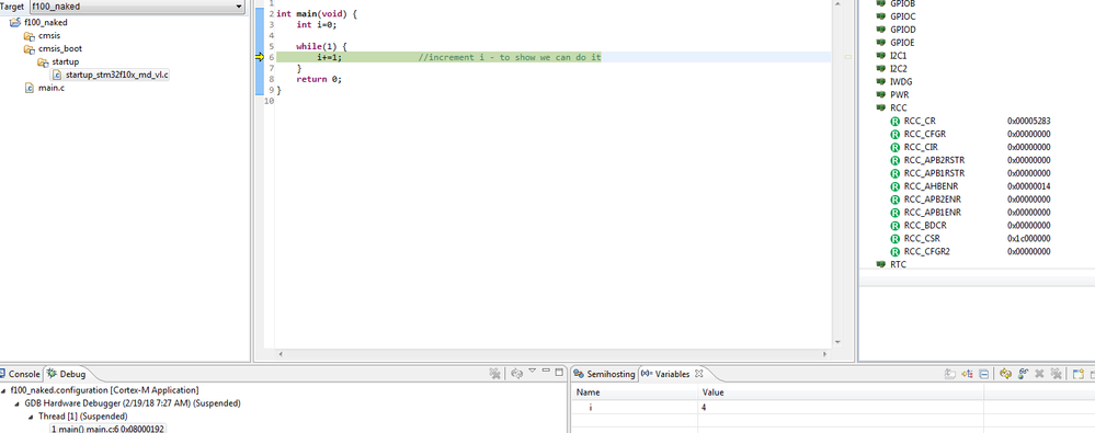

I think the answer is yes.''
I can confirm it for you that the following program, with ST start-up file, ran flawlessly on a F100 board, both in simulation and in actual hardware.
the only change made to the stock start-up file is to get rid of the reference to SystemInit(), which we don't have here for obvious reasons.
so for your purposes, you can simply load up the benchmark files and watch dwt counts, or if you want, set up SysTick for that.

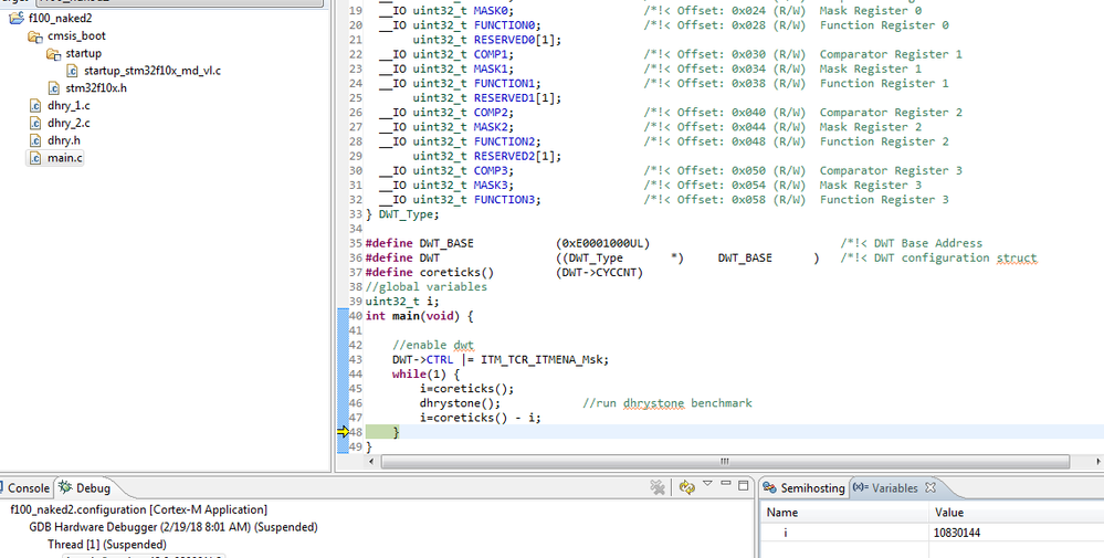

2018-02-19 6:06 AM
here you have it, for the dhrystone benchmark, on a F1:
I basically put in the dwt defs, stolen from stm32f1xx.h, into the code posted earlier. No device-specific header files, no custom-written start-up files, + just ''standard'' libraries. and the backend is gcc-arm.
it took about 11 million instructions to run through the dhrystone benchmark, on an actual chip. the same code should run on a (decent) simulators as well.
