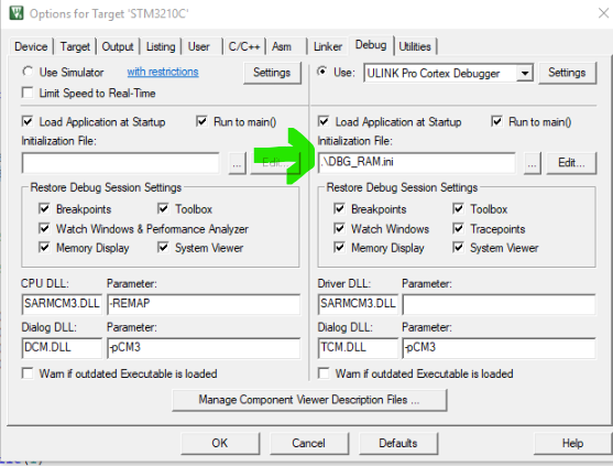

I was thinking.
Our debugger can function correctly before we run into mian().
and we debug the first beginning place is reset handler
but CUBEMX initialize the debug access port in the main() function.
I don't understand why to do that.

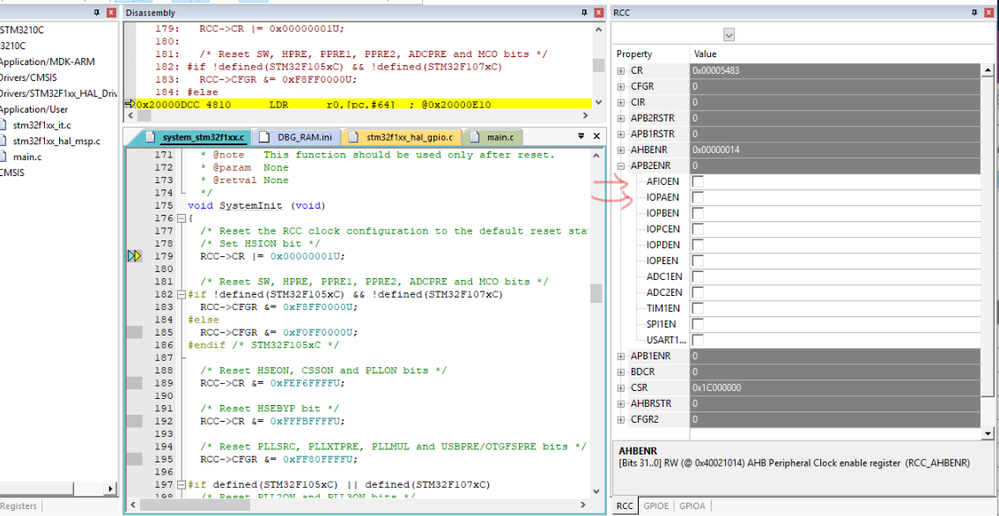

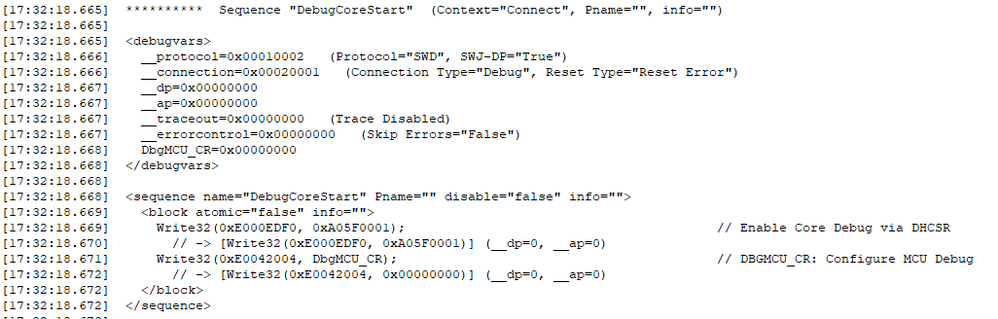

No, we can debug before main()! even though none of the clock (AFIO or GPIOA) is disabled.
Maybe all is handle by KEIL under hook.

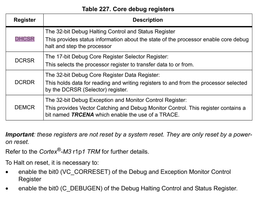

Taken from F1 Reference Guide.
Bits 26:24 SWJ_CFG[2:0]: Serial wire JTAG configuration
These bits are write-only (when read, the value is undefined). They are used to configure the SWJ and trace alternate function I/Os. The SWJ (Serial Wire JTAG) supports JTAG or SWD access to the Cortex® debug port. The default state after reset is SWJ ON without trace. This allows JTAG or SW mode to be enabled by sending a specific sequence on the JTMS / JTCK pin.2018-03-04 2:47 AM

uVision debugger take control of these register. I don't know why CUBEMX doing its configuration it the main(), they can just change the pin color to green and not doing anythingin the mian(). It also freeze me with my trace configuration. Please refer to my tracing with stm32 question.
