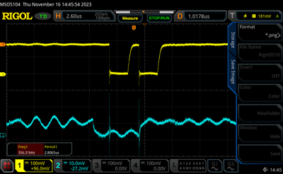

I trying to interface MAX6651 Device using I2C module using STM32F410C8U6 MCU.
Device address is 0x36 But when i'm using
HAL_FMPI2C_IsDeviceReady(&hfmpi2c1, 0x36 , 2, 100); this API returning the value
HAL_ERROR.
Here are some snaps
Anybody look into it send some solutions

2023-11-22 1:36 AM
hello @Pierre_Paris
