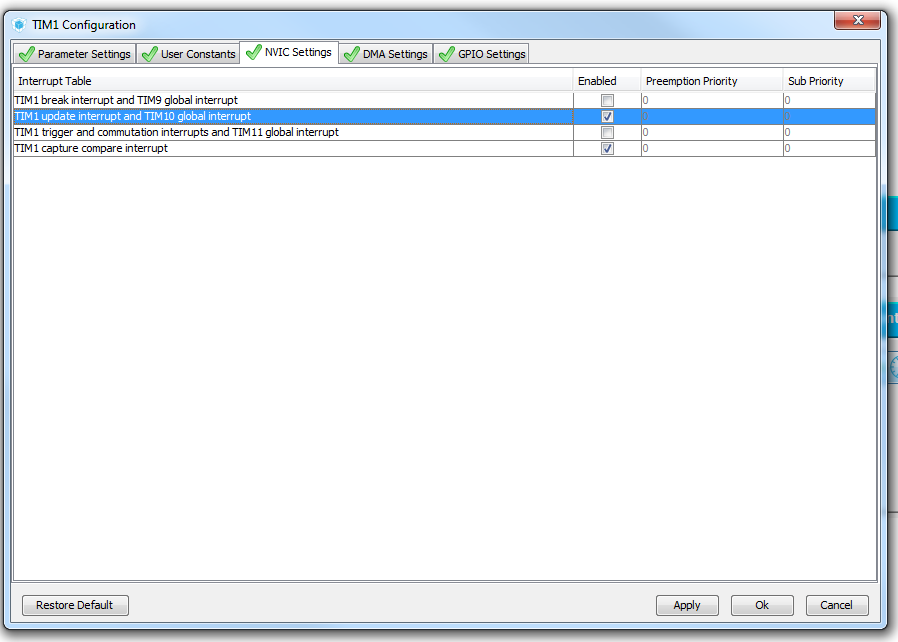

Thank you for your answer!
My code is based on the STM Cube generated code.
Ok, so I enabled TIM1_UP_TIM10_IRQn and TIM1_CC_IRQn in the dedicated MSP function.
This is my OC configuration :
__t_ConfigOC.OCMode = TIM_OCMODE_PWM1;
__t_ConfigOC.Pulse = 63; // default 6.3ms __t_ConfigOC.OCPolarity = TIM_OCPOLARITY_HIGH; __t_ConfigOC.OCNPolarity = TIM_OCNPOLARITY_HIGH; __t_ConfigOC.OCFastMode = TIM_OCFAST_DISABLE; __t_ConfigOC.OCIdleState = TIM_OCIDLESTATE_RESET; __t_ConfigOC.OCNIdleState = TIM_OCNIDLESTATE_RESET;I start the PWM using HAL_TIM_PWM_Start_IT(&_t_HTIM1, TIM_CHANNEL_3) function.
I go to the CC Handler but not into the Update Handler. Do I miss something?

Both interrupts can be handled with the global
TIM1_IRQHandler
AFAIK there's no such.
(for TIM1 particularly, there are separate interrupt vectors for update and for the captures, so you don't need to distinguish them in the ISR)

Marc2018-02-01 8:38 AM
If he generated the project with CubeMX, and enabled the TIM1 global interrupt there is!
he would have a handler like this;
void TIM1_IRQHandler(void)
{ /* USER CODE BEGIN TIM2_IRQn 0 *//* USER CODE END TIM2_IRQn 0 */
HAL_TIM_IRQHandler(&htim1); /* USER CODE BEGIN TIM2_IRQn 1 *//* USER CODE END TIM2_IRQn 1 */
}It calls HAL_TIM_IRQHandler(&htim1);
which then calls the event specific handlers;
void HAL_TIM_PWM_PulseFinishedCallback(TIM_HandleTypeDef *htim)
void HAL_TIM_PeriodElapsedCallback(TIM_HandleTypeDef *htim)
2018-02-01 8:44 AM
