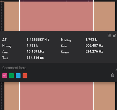

2026-02-03 1:14 AM
Hello @vamshi_kumar
I attempted to replicate your case and honestly, I did not encounter the issue you described.
I set PSC to 17999 and ARR to 19, and I obtained a 500 Hz signal, which is the expected result for this configuration, not 486 Hz.
I can attach the project if you want to test it.
You can track the PWM signal from PA11 by using a logic analyzer or an oscilloscope.
If the problem still persists on your side, try configuring PSC to 999 and ARR to 369.
With a 180 MHz frequency, this combination also produces a 486 Hz signal.
BR
Gyessine
