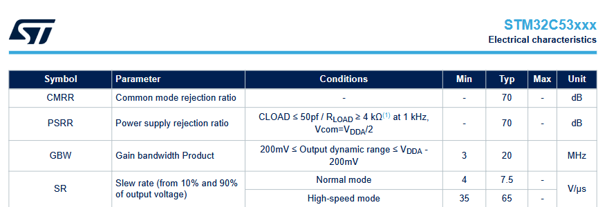

Any reason why the GBW of the OPAMP is having such a wide tolerance? Is it purely because the values are best-worst case design calculations?
In comparison, the Gx and Fx variants has better limits.
