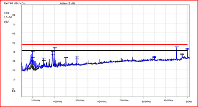

In our pre-compliance emissions testing, the product passed class B limits, but had emissions above the lower limit. The design is using standard best-practices for EMC compliance (e.g. solid power/ground places, good decoupling, controlled impedance board stack etc etc). Here are the results, red limit line is class B, black is the lower limit we have to pass.
Are some investigation, we found the emissions we all harmonics of the 50MHz RMII clock. e.g. at 400MHz, 950MHz, 1GHz.
Are further investigation we believe the issues is caused by ground bounce in the QFP package. The 50MHz RMII clock is causing the STM32 die to bounce at 50MHz and all its harmonics due to the lead inductance of the package. This causes all the other output pins to contain this harmonic content with respect to the board ground, and then radiate.
