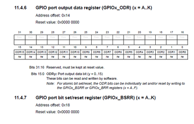

Globally what you need to configure for a GPIO pin to turn on a LED:
1- Enable the AHB clock of the GPIO port
2- Configure the GPIO pin on which the LED is attached in Output Push-pull
3- Set the corresponding bit where the LED is attached either on the ODR register or the BSRR register:
Hope that helps.

After downloading the GPIO settings from STM32CubeIDE, I directly manipulated the corresponding registers, and the LEDs lit up.
The site you sent me was very helpful.
