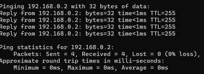

I tried following these tutorials/guides and managed to be able to ping the board but not get it to host the webserver.

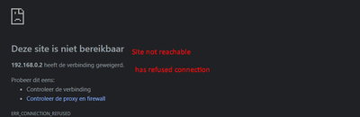

Im connected via a static ip and when I type the IP in the browser or any link to a page it refuses the connection. I also used Advanced IP scanner to check If it was hosting something, but there was nothing.

2024-03-19 7:34 AM
Well Chrome is being a bit vague, I get this:
so there is probably an error somewhere with the TCP transmission.
2024-03-19 7:38 AM
I think ERR_CONNECTION_REFUSED is probably at the TCP layer - so it's not even getting to your webserver?
2024-03-19 7:44 AM
Yes,
Its in Dutch but I translated:
this is with me trying:
I have aslo tried just the IP adres or the 404 from the github code.
I can ping my controller tho, so it doesn't crash.
2024-03-19 8:00 AM
Ping is UDP - so could well get through when TCP is refused ...
