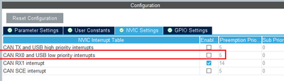

I generated the HAL with CubeMX. RX1 interrupt is enabled and the pins are left as default:

But looking at your code, I found the issue:
You're using FIFO0 while, the interrupt is configured for FIFO1. So you need to activate this interrupt for FIFO 0 (RX0):
Hope it does answer your question.

2024-03-27 3:43 AM
HI SofLit,
That made my day! I took the settings from some other tutorial. I overlooked the configuration in the tutorial I was referring to.
