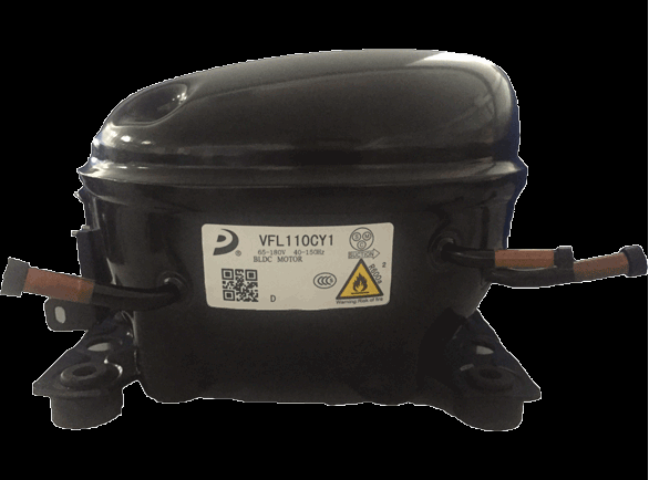

>>my compressor has no response.
Was it working before?
What kind of motor does your compressor have?
Because i have only seen induction motors for big ones or brushed DC for small compressors
How sure are you?
hit me up in https://www.linkedin.com/in/javiermu%C3%B1oz/
It was working fine before.
It's the freezer compressor, I removed it from my freezer.
0693W00000Y8MkhQAF.pngit comes with a controller but i want to make my own

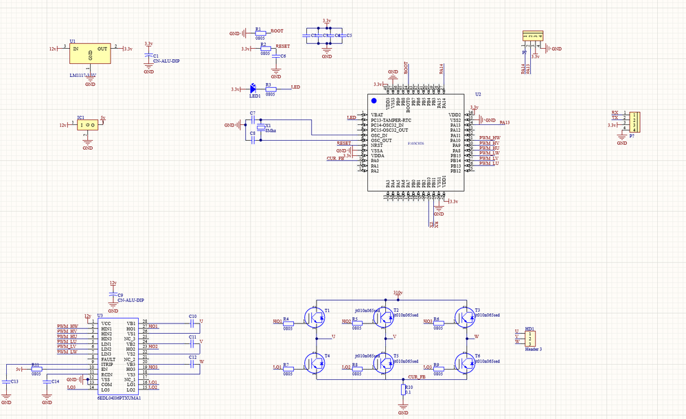

show us your setup : wiring, schematics and all that
Describe what it happens when you try to drive it, any error message? any noise?

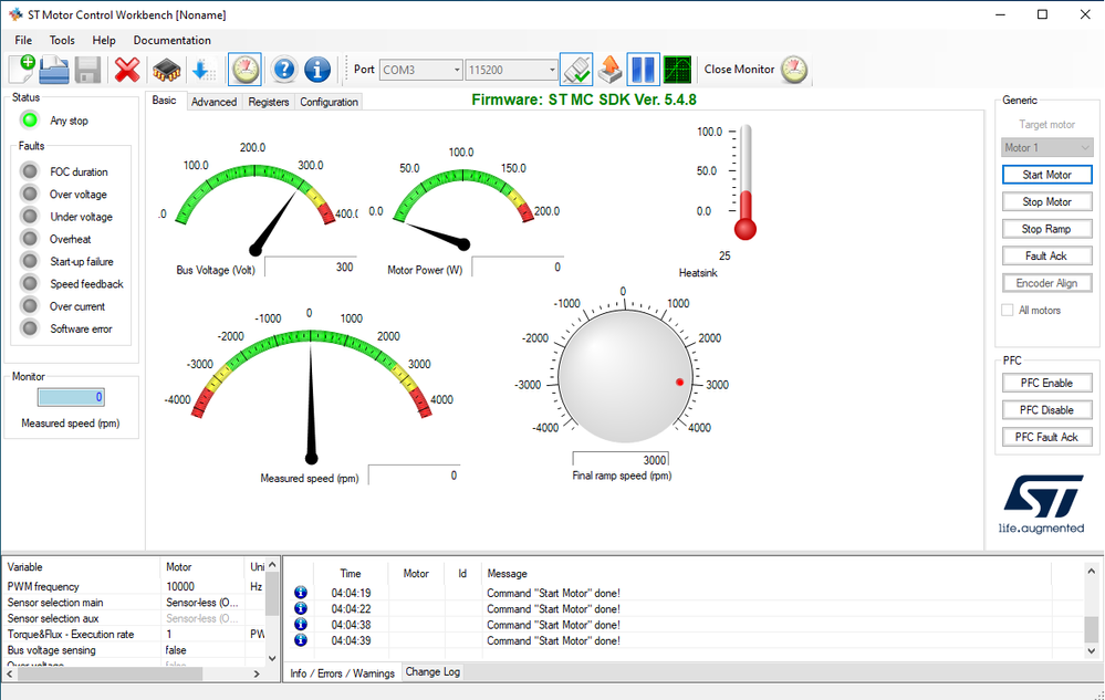

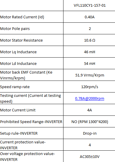

i get 12v and 310v from its controller and I made a simple circuit like this . 0693W00000Y8TyWQAV.pngI attached my project below and compressor specification
0693W00000Y8U0cQAF.pngwhen i press the start motor button, the motor has no response and the status shows idle start or unknow
Hi
Motor stator resistance should devide by 2
https://wiki.st.com/stm32mcu/wiki/STM32MotorControl:How_To_manually_configure_the_motor_parameters
