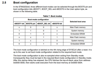

Check the boot configuration and the BOOT0 pin state with the default option bytes in the reference manual RM0454:
Make sure BOOT0 is High and reset board.

besides the BOOT0 pin, the option bytes can also be used for configure MCU runs into the system memory, where the bootloader exist.
for configure the option byte for boot from system memory, you need to set nBOOT_SEL to 1, nBOOT0 to 0, nBOOT1 to 1.
