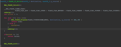

Hello, Flash writing is not working.
When i update firmware, then Writing is working well only one time.
But after this time, result is fail in HAL_FLASH_PROGRAM()
MCU : STM32F446RCT7
Thanks.

Please use the code pasting tool </> and not bitmapped screen shots.
Working once suggest you fail to erase the blocks on the second go around.
You don't show enough code to fully convey the context.
