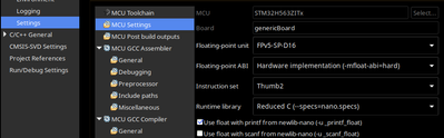

You are using...CubeIDE ? ( no info given)
in menu -> project -> properties :
-> -mfpu=fpv5-sp-d16 -mfloat-abi=hard
2023-12-26 4:05 AM - edited 2023-12-26 4:08 AM
