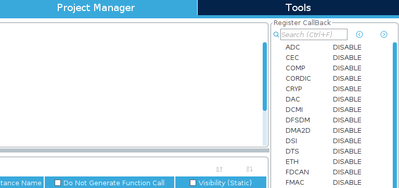

}Of course the FDCAN2 interrupt 0 is activated on CubeMX :

did you enable callback in Cube ?
