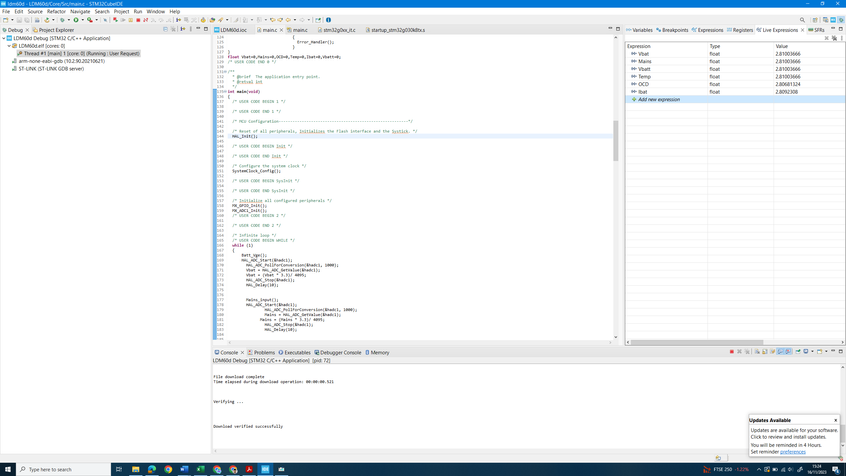

2023-11-20 7:21 AM
Thanks for the reply.This is what like I configured The no.of conversion made to 6 also getting same values
void ADC_Vbat(void)
ADC_ChannelConfTypeDef sConfig = {0};
sConfig.Channel = ADC_CHANNEL_16;
sConfig.Rank = ADC_REGULAR_RANK_1;
sConfig.SamplingTime = ADC_SAMPLINGTIME_COMMON_1;
if (HAL_ADC_ConfigChannel(&hadc1, &sConfig) != HAL_OK)
Error_Handler();
HAL_ADC_Start(&hadc1);
HAL_ADC_PollForConversion(&hadc1, 1000);
Vbat = HAL_ADC_GetValue(&hadc1);
//Vbat = (Vbat * 3.3)/ 4095;
HAL_ADC_Stop(&hadc1);
void ADC_BattIsense(void)
sConfig.Channel = ADC_CHANNEL_3;
sConfig.Rank = ADC_REGULAR_RANK_2;
Error_Handler();
BattI = HAL_ADC_GetValue(&hadc1);
void ADC_ledIsense(void)
sConfig.Channel = ADC_CHANNEL_2;
sConfig.Rank = ADC_REGULAR_RANK_3;
Error_Handler();
LedI = HAL_ADC_GetValue(&hadc1);
void ADC_Temp(void)
sConfig.Channel = ADC_CHANNEL_0;
sConfig.Rank = ADC_REGULAR_RANK_4;
Error_Handler();
Temp = HAL_ADC_GetValue(&hadc1);
void Open_Circuit(void)
sConfig.Channel = ADC_CHANNEL_9;
sConfig.Rank = ADC_REGULAR_RANK_5;
sConfig.SamplingTime = ADC_SAMPLINGTIME_COMMON_2;
Error_Handler();
Opv = HAL_ADC_GetValue(&hadc1);
