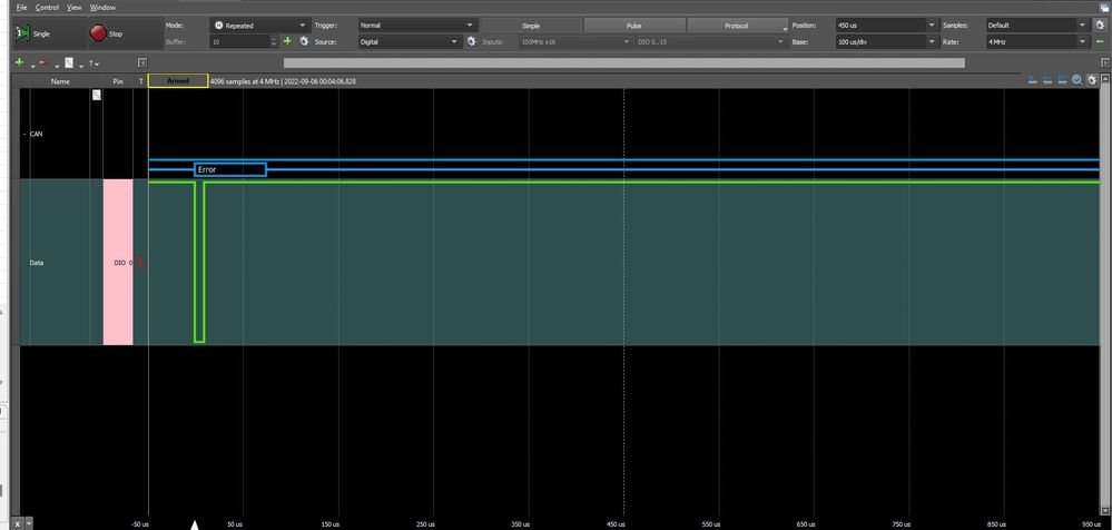

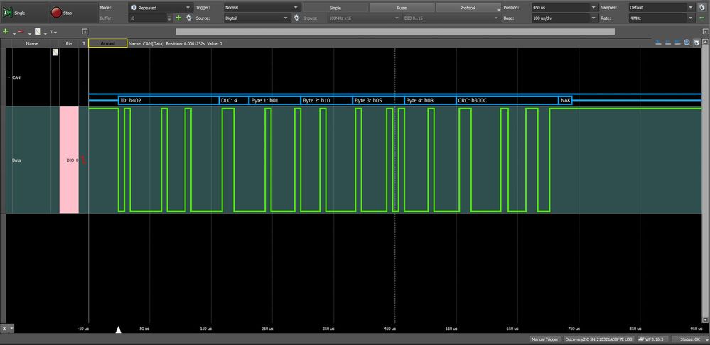

I've set up FDCAN on my STM32H753. I'm reading the transmissions using both an oscilloscope and an Analog Discovery 2.
I'm currently debuggning a loop which transmits the same message over and over again.
About half of the times I only get the SOF-bit and then nothing more, the other times I get the full correct message.
The second image, is the one with the correct result. I transmit the same message each time but still get different results.
When I get the wrong result when transmitting, HAL_FDCAN_EnableTxBufferRequest(&hfdcan1, FDCAN_TX_BUFFER0) still return HAL_OK

Suddenly I can't get any correct transmissions any longer. I.e. I only get the SOF-bit. Nothing in the code has been changed, no settings has been changed either. Double and tripled checked the wires - all looks good.
I guess this could have something to do with it. However I can't really figure out what the issue is.
FDCAN_PSR.LEC = 0x05 - Protocol Status Register Last Error Code
From datasheet: LEC=0x05 Bit0Error: During the transmission of a message (or acknowledge bit, or active error flag, or overload flag), the device wanted to send a dominant level (data or identifier bit logical value 0), but the monitored bus value was recessive. During Bus_Off recovery this status is set each time a sequence of 11 recessive bits has been monitored. This enables the CPU to monitor the proceeding of the Bus_Off recovery
