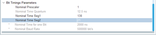

2025-05-28 2:24 PM
Your IOC file shows the FDCAN clock is 80MHz
Based off that, your settings should be as following to get 500000 bit/s
