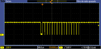

I'm using the 2 transceivers TCAN1463-Q1 of Texas Instruments, one for the nucleo board and another for the custom board, same connection.
I was able to transmit with the custom board, but the signal looks like this:
I searched and I found out that this is probably due to the TX line, but I don't know what is causing it.
Have you ever encountered behaviour like this?
I'm clousing the post because i think that the problem is in my board.

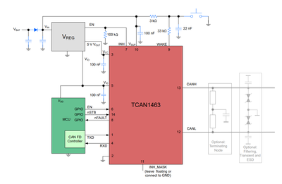

2025-08-27 12:59 AM - edited 2025-08-27 1:11 AM
Check your HW especially the transceiver part:
Power supply (VCC), VIO pin level voltage, EN pin, Standby pin level voltage etc..:
