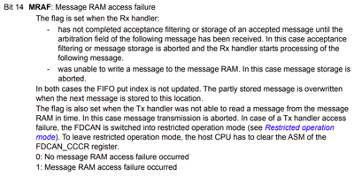

My leading suspect is the lack of HSE. Could you explain to me why that would cause MRAF errors and not some other type of error?
Additionally, after further reflection on the MRAF description:
has not completed acceptance filtering or storage of an accepted message until the
arbitration field of the following message has been received. In this case acceptance
filtering or message storage is aborted and the Rx handler starts processing of the
following message.
Is it possible my FDCAN Kernel clock is too slow and thats why it cant complete the acceptance filtering in time? It was was 64MHz but I upped it to 100Mhz. However, its still throwing MRAF errors. Does it need to be even faster?
Additionally, you mentioned increasing the number of extended filters. Why is that? I only configure a single filter so only a single filter slot should be needed. Am I missing something?
Thanks,
Daniel
