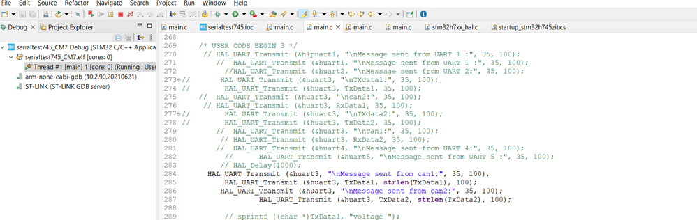

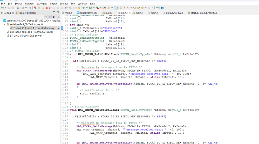

i have used the board nucleo stm32h745 Board.
i have used can 1 and can2 for data exchange but my data is also showing with some simple text ,screenshort is attached.
i am sending voltage text at can1 and hello at can2,
and but i am getting some text we this data ,
while i am printing that data is attached below
what i am doing wrong ?
