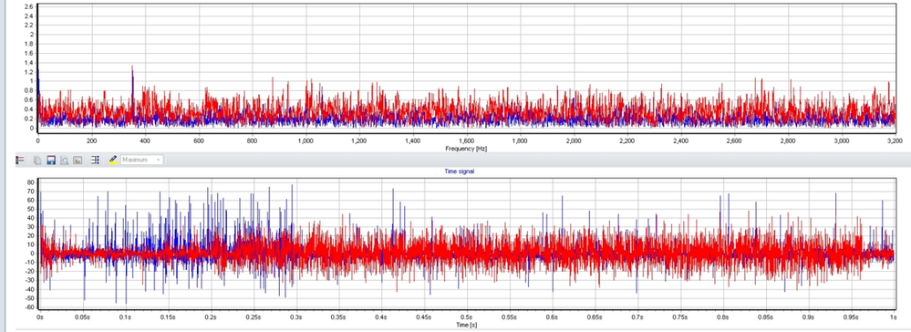

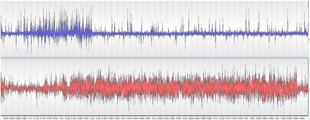

When we test adc small signals, we found all spi have impact on adc1 and adc2 module, which leads unexpect singals even we use fund HDs of it.
Detals as below:
--Environment:Save 6400 points at different conditions,
1. spi2 or spi4 work and really has impact on adc(somtimes happen, expecially large data trans)
2. Spi2 or spi4 work but not impact on adc
--Signal meaning:
Red -->> spi2 or spi4 work and really has impact on adc
Blue -->>Spi2 or spi4 work but not impact on adc
--Feature1: frequency and time base analysis of 6400 points
--Feature2: time base compare of 6400 points
--My opinion:when spi transfer data, spi will impact all adc, brings larger noise at relative longer time. This means larger energy(uniform at all frequency spec.) at certain time. So even we use fft to get fund HDs of this signal, we also can not filter the noise.
--My expect result:1.the reason spi impact adc module, 2.any methos to avoid it, 3.will all spi impact all adc?

No, errata sheet still not carefully fefer to find the limitations. But currently we do a lot of test to confirm the issue. For example:
1)use different spi and adc(same port and different port situations all cover), not work
2)connect suffix_c pin to ground, not work
3)use external adc reference and external power source to supply MCU, not work
4)connect all adc pin to ground, not work
5)physically cut down spi pin, not work
6)and so on...what we can think out
For reply3
yes, adc works properly when spi not use, the noise happen(not every time) when spi use at high frequency
For reply4
I think this issue can be reproduce by simply configure the cubemx for adc and spi, this issue we find in our different hal configure and different hardware platform.
