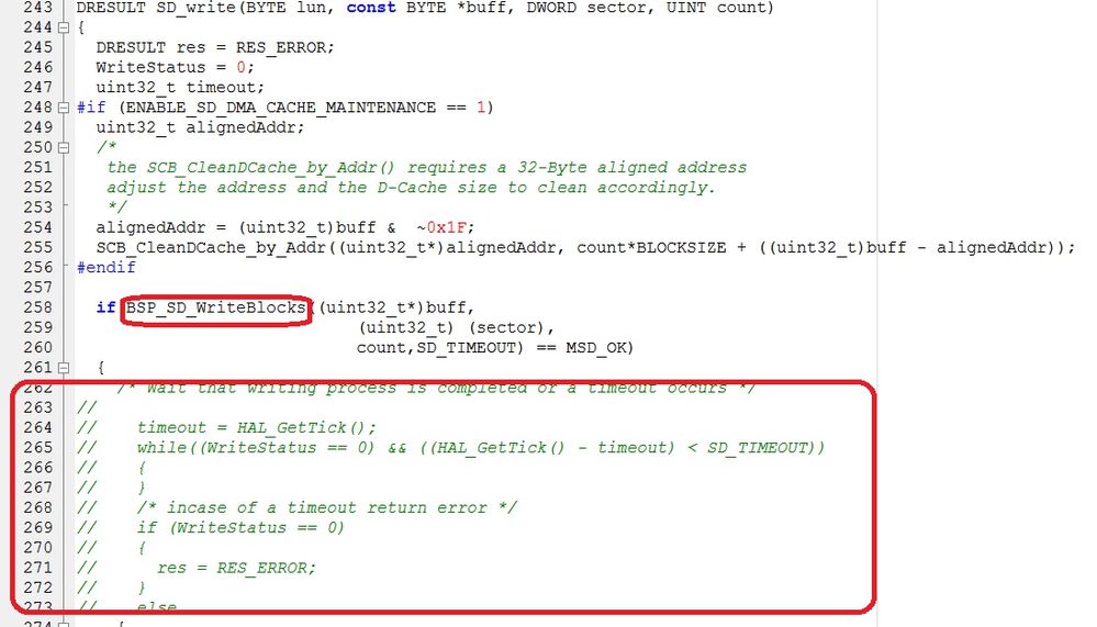

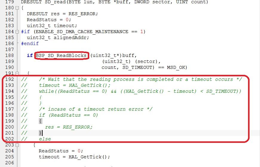

The Cube was configured to use FATFS with SD Card and the SDIO with 4bits interface was chosen, no DMA was configured. In the sd_diskio.c file, automatically created, the code assumes that the DMA will be used (function called is BSP_SD_ReadBlocks_DMA) and there is no #ifdef to change it. So, the f_open wouldn't work due to the SD_read and SD_write function error. The solution was quite simple once identified:
Read:
And SD_write:

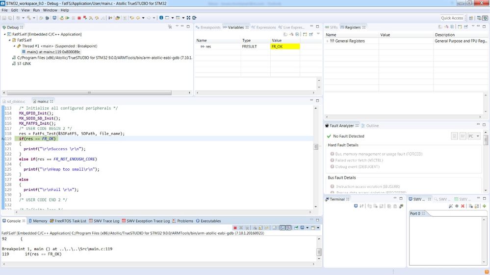

with only these changes, it all worked properly:
The code was tested using the Nucleo F401 and the full project is available
https://drive.google.com/open?id=1X9N9ob7u3TxycgdhRcjCDtWx8Qj-02h_
;Sure I could add a #ifdef to get a better code format, but this was just a quick fix.
Hope this can help
