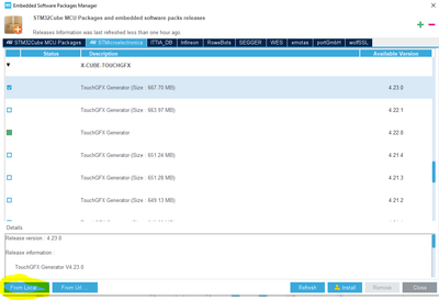

Try download and install the X-CUBE-TouchGFX manually into STM32CubeMX.
After download the package, you need to install it by using "From local" option in the Help >> "Manage Embedded Software Packages" option in STM32CubeMX (please see the screenshot below - "From local" option in the bottom left, with yellow color).
Then, select the X-CUBE-TOUCHGFX package (zip folder).

2024-03-27 3:44 AM
Thank you. That solved the issue with CubeMX not recognizing TouchGFX version 40.23.2.
Both issues have been resolved.
