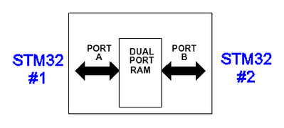

@KDJEM.1 wrote:To enable high-speed communication between two STM32U5G9 chips, you cannot use OctoSPI or HexaSPI.
Unless you use a dual-port RAM ... ?
