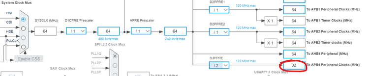

PCLK4 is here in the clock tree and depends on everything directly upstream of that node.
It doesn't depend on D1PPRE or D2PPREx.

SPI6 is mapped to APB4 and the maximum APB4 clock frequency is 120 MHz.
If SYSCLK is 480 MHz, you must set APB4 prescaler to divide by at least 4 to keep APB4 ≤ 120 MHz.
Depending on SPI mode and your operating conditions, you need to be aligned with max SPI clock frequency as specified in product datasheet (see "SPI interface characteristics" section).
