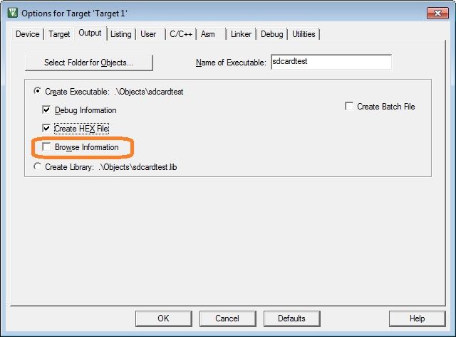

In Keil uncheck options to generate Browse Information

Perhaps a picture?

Keil has some egregious issues with the browse information (at least in the 5.x compilers) where a rebuild of a HAL example might take several minutes, and perhaps 10x or 20x slower than necessary.
