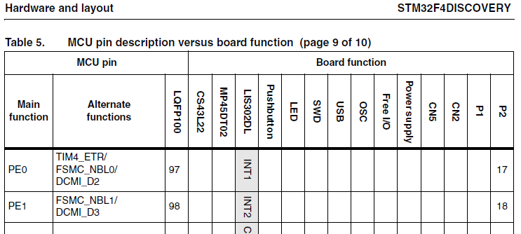

You understand that PE0/PE1 are connected to other components on the board, right?
PE3..15 are not connected to anything. Make sure the clock is enabled for the GPIOE bank, that you can read/write values into the registers.2013-04-21 4:27 AM

clive !
My hero ! i neglected to look at the board datasheet itself !Now i understand :)(just maybe next time indicate the doc reference, had a hard time digging this one)thanks a bunch !jegevaWe’re moving the ST Community to a new platform to give you a better and more reliable community experience.
