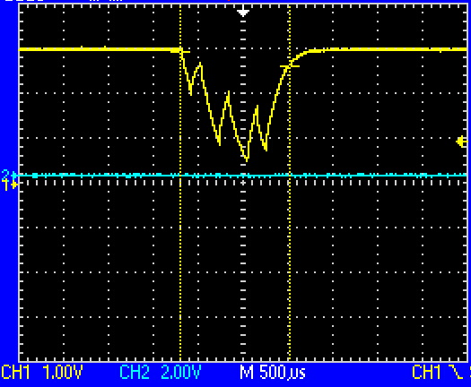

I see a very gruesome trace out of PA9:2012-03-26 7:58 AM
Dunno, is USART1 viable on the STM32F4 Discovery on these pins? Check the schematic.
Always assume the hardware isn't going to magically configure itself. Review some of the peripheral examples to get a feeling for how it's done, the API documentation mostly describes the functions, the reference manuals are the best place to understand the hardware. I've been using USART3, I had to mod this example to get you USART1. Here's a build using PB6,7 as the USART1 pins// STM32 USART1 (Tx PB.6, Rx PB.7) STM32F4 Discovery - sourcer32@gmail.com

It works with the alternate pins (PB6 as TX). PA9 is connected to an LED which is why it is capacitively slowed and creates a nasty trace (might work at 1200baud :-).
Thank you for your help!2012-03-27 12:29 AM
you can see on STMF4 Discovery user manual (page 34): on the PA9 there is a 4.7uF capacitor. If you want to use UART1 TX then you must remove this component and you must care about PC0, you must keep it HIGH. I suggest use UART6, the pins for UART6 is near to UART1 on the header. (PC6 Tx, PC7 Rx). cd3342012-03-27 3:59 AM
